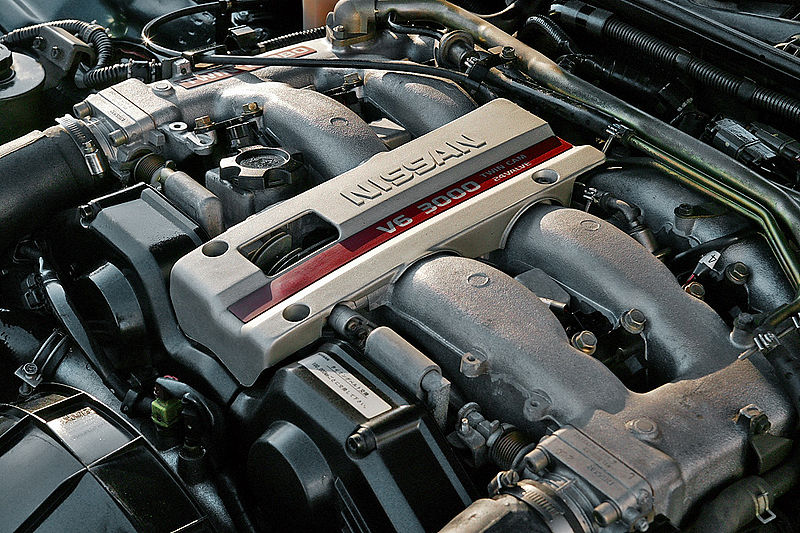

вот такой
VG30DET
The VG30DET is a 3.0-liter, 24-valve, quad-cam, VTC-equipped engine equipped with a T3 (Nissan N1 Type) 4-bolt Garrett Turbo running between 7.5 and 11.5 psi. Generating up to 255 hp (190 kW) and measuring 236 ft·lbf (320 N·m) per foot depending on boost level, intake manifold, intercooler, and other factors.
While this engine is similar to the VG30DE, it used different heads and inlet manifold. Contrary to popular belief, it was NOT available in the Nissan 300ZR model - the 300ZR only had an early version of the VG30DE (no turbo). The engine was available in the Cedric, Gloria, Cima and Leopard chassis.2 It's a single-turbo engine that was used from 1987 through 1995 in Japan and the predecessor for the VG30DETT, the engine that was released in the 1990 300ZX Twin-Turbo.
It was available in the following vehicles:
Nissan Cedric Y32 (1991–1994)
Nissan Gloria
Nissan Cima FY31 (1988–1991)
Nissan Leopard
Nissan Gloria
а потом был еще такой и ставили на
1987 Nissan MID4-II Concept (Not-Production)
1989–2000 Nissan Fairlady Z Twin Turbo
1990–1996 Nissan 300ZX Twin Turbo
The VG30DETT was developed for the 1987 MID 4-II and produced 330 PS (240 kW). [1] It was the last of the 4 valve belt drive DOHC turbocharged engines into production being preceded by the CA18DET and RB20DET
The production 3.0 L (2960 cc) VG30DETT produces 300 hp (220 kW) and 283 ft·lbf (384 N·m) when mated with a 5 speed manual transmission. When mated with the 4 speed automatic transmission, it was rated at 280 hp (210 kW) and 283 lb·ft (384 N·m) of torque. It featured twin T25 turbochargers, twin intercoolers, and NVCS(Nissans Valve Timing Control System).
It is used in the following vehicles:
