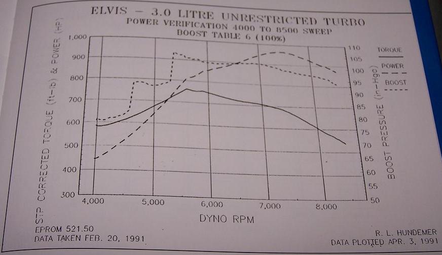

Electramotive GTP ZX-Turbo ("Elvis" Chaises)
965RWHP 760RWTQ (unrestricted)
IMSA GTP class race car
Nissan VG30ET engine with extensive race modifications
8.5:1 compression
Staged fuel injection with electramotive's own EFI system.
Single Garrett T04 series turbo of unknown specs, ~50PSI boost with Electramotive designed electronic multi-stage boost cont
