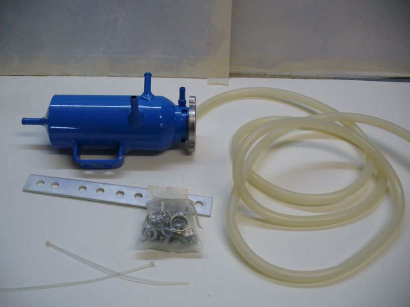

- Маслоуловитель

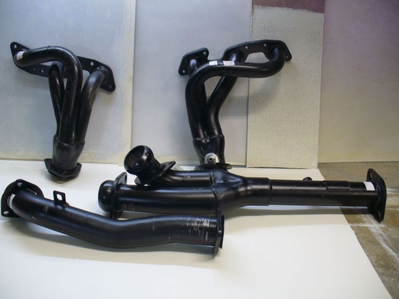

- Выхлопные коллектора, Y-pipe “Pacesetter”
- Термоизоляционный бинт “DEI” c обработкой силиконом “Automotive Thermo Tec”

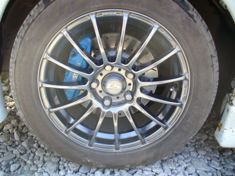

- Диски Kosei Seneka 17x7 лето, LS Racing 16x7 зима

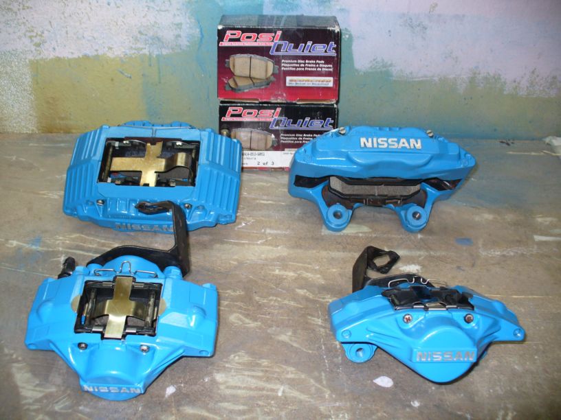

- Тормозные суппорты от Z32 турбо: перед 4-х поршневые, зад 2-х поршневые, покрашены в голубой цвет

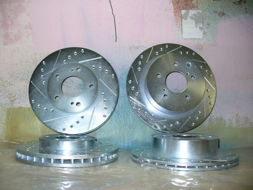

- Тормозные диски от Z32 турбо с перфорацией и насечкой “Stoptech”
- Металлокерамические тормозные колодки “Posi-Quilet”
- Армированные тормозные шланги “Goodridge”

Это ещё не все спеки. Полный список будет после турбирования.

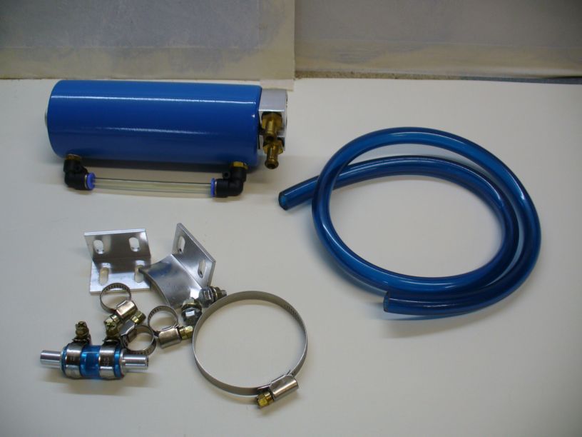

Looks like you've made some additional changes to the car since I last viewed it! Looks good!
I think there are some things you could do without. I believe you do not need the stainless steal brake lines. I have actually heard of them leaking, so be very attentive to fluid leaks and the level in your master cylinder.
I am not sure why you got the water temperature guage since the car has a functional guage already. Also, I believe you will find the oil catch can you bought is useless. I say this only because I purchased two of the similar design. The ports and hoses are way too small to be effective. Additionally, the ports coming off the front and rear valve covers are significantly larger than those on the oil catch can. It will be very difficult to adapt them down. This is exactly why I had to fabricate my own catch can.
I imagine if you do not replace your old rings, you might have a problem with blow-by (oil being pushed out of the valve covers due to presureization of the crank case). However, if your rings are new or good, then you should have no problem with blow-by. I suggest you not install the oil catch can unless you begin to see oil being pushed out of the valve covers. Keep in mind at least one port should be vented by a filter, at minimal....and retain the stock PCV valve. I also recommend a PCV valve installed in line to your brake booster to avoid presurizing the booster.

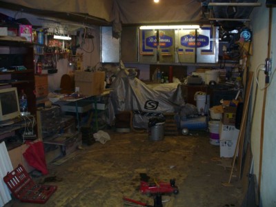

Было дело в 2007 г. Отгонял машину туда для проверки электрики к Рокеру, пока он там работал. А гараж на фото именно тот где я делаю свой авто. В Ё-бурге никто так машины делать не может, делают только на отъеб.сь. Поэтому делаю сам. Если что надо, то обращайся.Тёмсон писал(а):Олег, а где у нас в Е-бурге так машины делают? Я видел Ваш а/м в сервисе на Институтской где-то в 2006-07 гг? Или я путаю что-то? На фото вроде не тот гараж?
